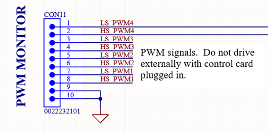

  1. Can I connect the PWM output (0–3.3 V, single-ended) from the TMDSDOCK28335 to the CGD12HB00D, and then use its differential output to drive a suitable gate driver module mounted on the MOD-MB-3P-0900V-40A-N? If so, please recommend a compatible gate driver module.

    • 1. Can I connect the PWM output (0–3.3 V, single-ended) from the TMDSDOCK28335 to the CGD12HB00D, and then use its differential output to drive a suitable gate driver module mounted on the MOD-MB-3P-0900V-40A-N? If so, please recommend a compatible gate driver module.
    You do not need the CGD12HB00D. The Speedval mainboard already has differential transceivers onboard. Since you are not using the NXP controller card, you can inject your single ended PWM signals via connector CON11.

    You have a couple of options for this. All the voltage and current feedback signals are available at the control card connector and you could get them from there. The other option is there are test points placed at the output of each voltage sense differential amplifier and each current sensor output. You could grab the signals there as well. I have attached the schematic.
