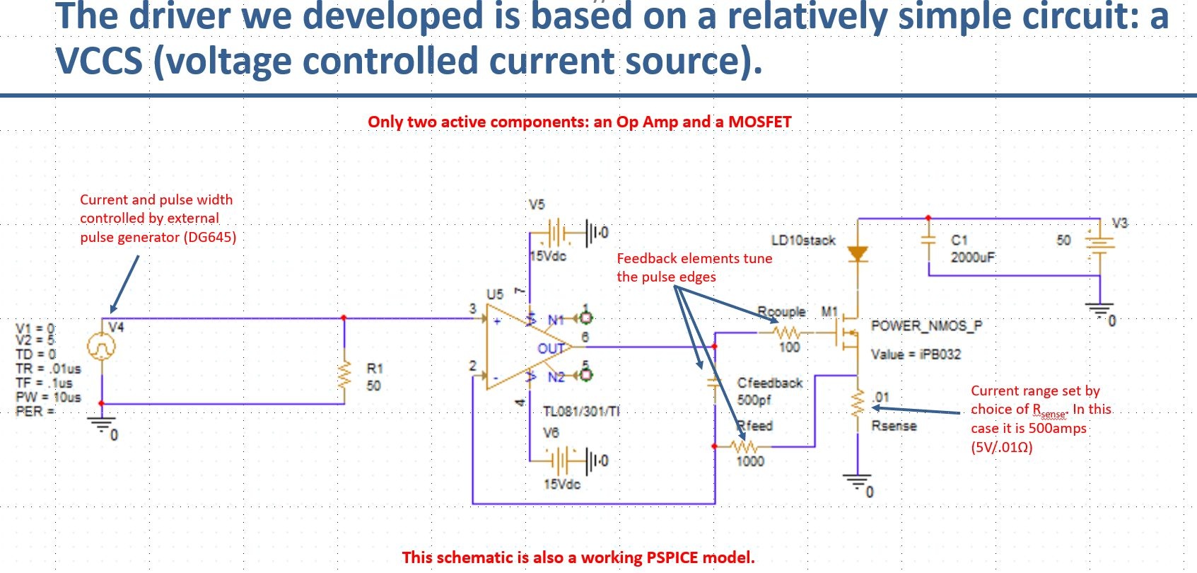

I would like to help selecting a MOSFET for my application. I am building a laser diode driver configured as a high-side voltage controlled current source. The laser diode is on the high-side, a current sense resistor is on the low-side, and an op amp tries to keep the current (voltage across the sense resistor) equal to a rectangular input pulse from an SRS DG645.
Pulse width:10-microseconds
Rise and fall times: about 1-microsecond
Rep rate: once every 10 seconds, essentially no average powder
Drive voltage (0-500V)
Current pulse (0-600amps)
It would be OK to parallel a small number of MOSFETS but I don't want to put any in series so I figure I need at least a 750V device. I need a device that is in stock at the usual distributors.
A low voltage prototype is shown in the attached diagram. Now I need to scale it up to about 500V.
