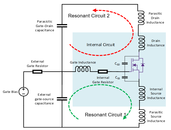

    For the 3L MOSFETs, the source inductance Ls (device + PCB) is part of the gate drive loop. The Ls contribution of the PCB most times is in the range of 5-20nH. The addition of an external Cgs creates a RLC resonant circuit with the internal Rg and this Ls shown in the figure below:

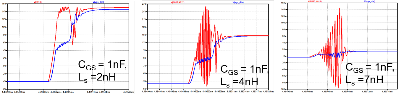

    This resonant circuit can contribute to oscillations (sometimes even sustained oscillations) from the gate to source depending on the switching speed and the value of Ls. You can see the effect of increasing Ls with a 1nF external Cgs below on the gate oscillations (in red).
    I recommend using MOSFET packages with a kelvin source pin as it isolates the gate loop from the power loop. Minimizing your overall loop inductance is very critical if you're using 3L MOSFETs.
