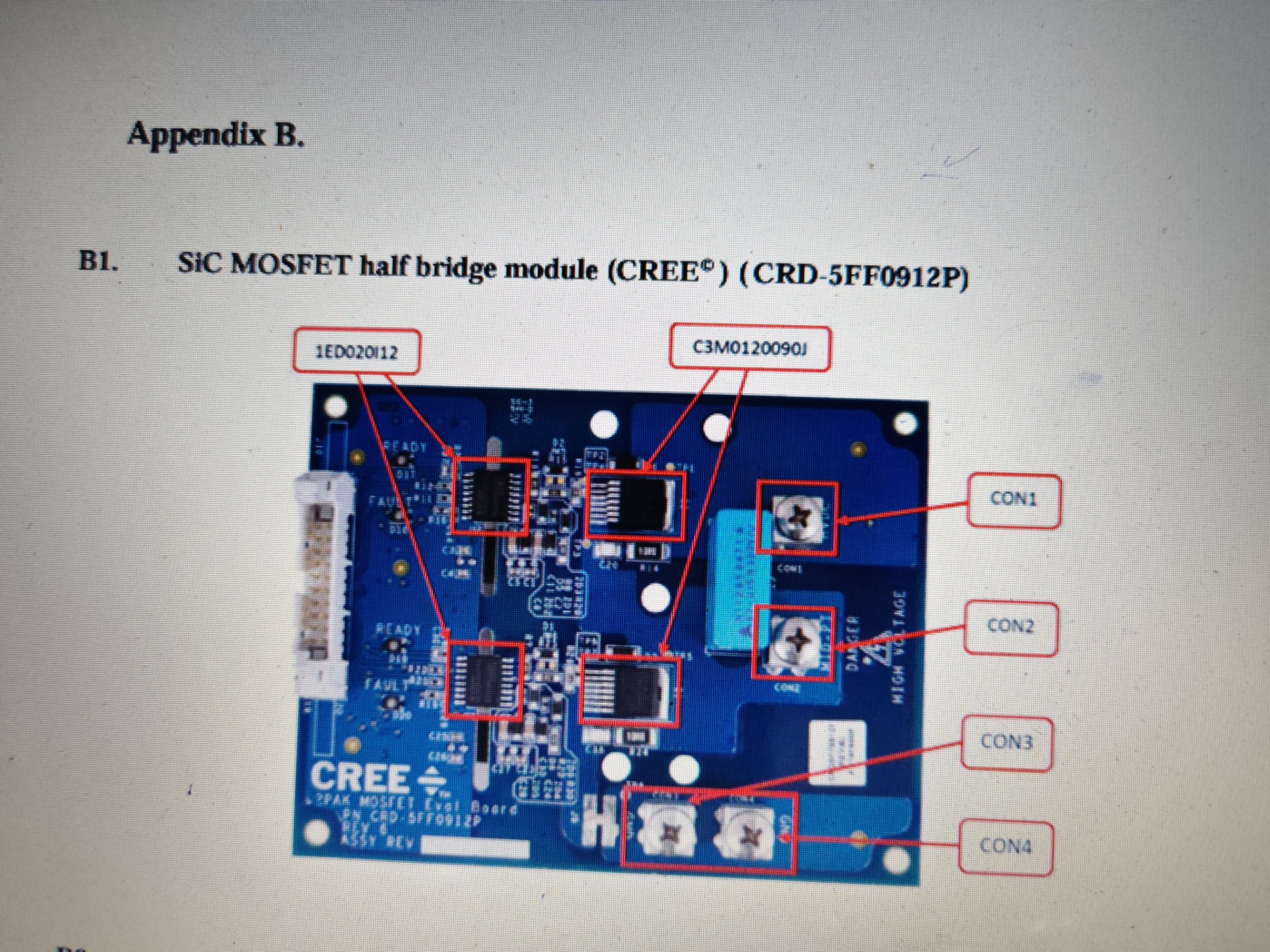

Per customer, “Is the SiC MOSFET half bridge module inverter (CRD-5FF0912P) working in 1MHz or switching frequency is 1MHz?? “

    CRD-5FF0912P is an old evaluation platform that was meant for Clamped Load Inductive or Double Pulse Dynamic Test. What I believe it means by the language of being able to switch at "2MHz" is the total pulse width for the CIL test can be as low as 0.5us. This board is not meant for continuous operation at a 2MHz switching frequency and we no longer support this board.
    Please refer to our new evaluation platform for discrete devices SpeedVal™ Kit Modular Evaluation Platform.
