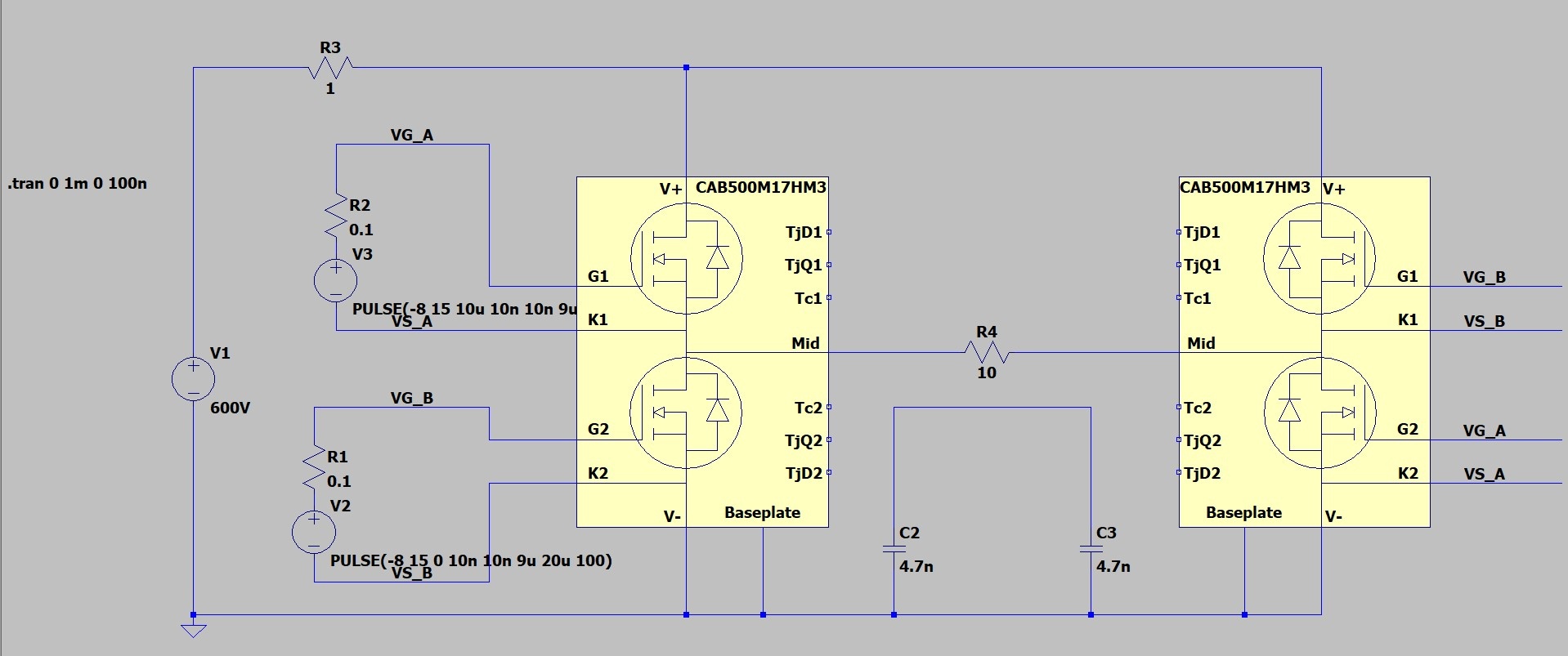

I'm trying to simulate the circuit you can see in the picture.
From the simulation results with LTSpice it seems that the hi-side MOS doesn't switch well, most of the 600V drops across the D-S junction.
As you can see, I'm driving with -8/+15V with a 50kHz frequency.
The model is the one available in the Spice tool, so I'm confident that is correct.
Could you kindly give me some suggestions about this misfunctioning?
