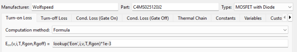

Also, I found that this function is also unable to import models that contains "lookup" function for example C4MS025120J2. This is how the lookup function is implemented in PLECS.

    The Wolfspeed MOSFET and diode XML models were recently updated (around Nov 2025), andee_importDeviceParameters may not be able to handle this newer model format yet. If you check the ee_importDeviceParameters documentation, in R2025a it states support for importing Wolfspeed-format XML for MOSFET, Diode, and Half-Bridge models—but the import support is still limited in what model structures it can parse.
    Also, the importer is mainly designed around the 3D LUT-based switching-loss approach, where switching energy (Esw) is scaled vs gate resistance (Rg) using a scaling equation. In the newer Wolfspeed PLECS models (after PLECS 4.9), switching loss is implemented using 4D LUTs for Esw (higher accuracy than 3D LUTs). Those 4DLUT structures (and “lookup”-style implementations) are not something ee_importDeviceParameters can interpret today, which is why the import fails for “MOSFET with Diode” and for models containing lookup.
    Practical workaround: Use the legacy separated MOSFET + body diode XML models (since those import successfully) or implement them manually by adding the Eon(I,V), Eoff(I,V) LUTs until MathWorks adds support for the import of newer Mosfet and Diode XML format models.
