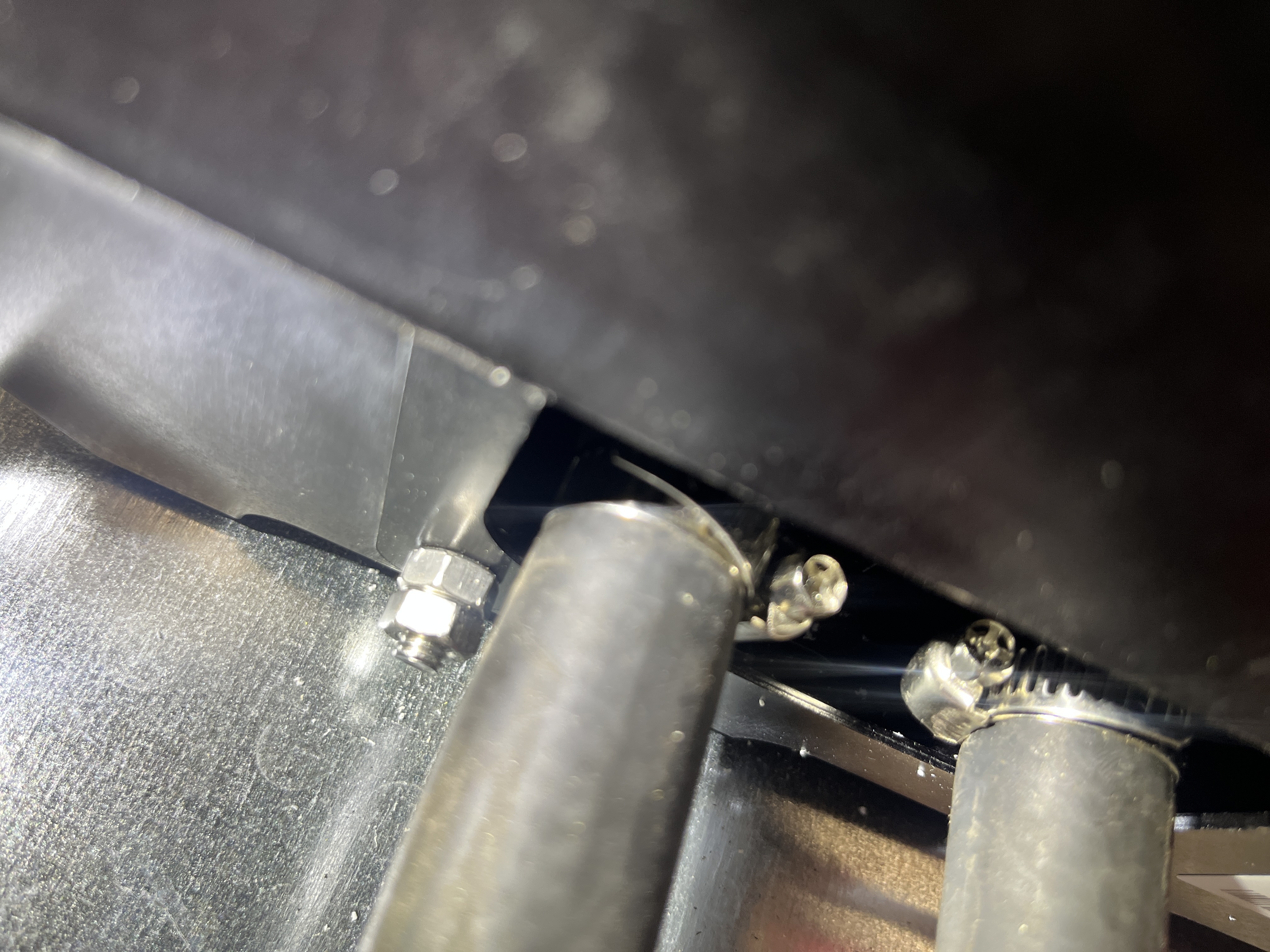

Hi,
In the user manual for the CRD250DA12E-XM3, Section 2.7 states: “Connect the grounding stud to an earth ground connection for safety. The grounding stud is connected internally to the cold plate and module baseplates.” There is also a warning indicating that the ground connection must be made before the unit is energised.
Could you please confirm whether the stud shown in the photo below is the grounding stud referred to in Section 2.7? The wire connected to the stud behind the housing appears quite small for an earth/ground conductor.
Many thanks.
Kind regards,
  • ChrisN
    ChrisN Wolfspeed Admin - Contributor Level 5
    Hello ZAO,
    The stud shown in your picture is the correct Earth ground stud. That stud connects to the cold plate of the design. It is a smaller wire gauge since it is not intended for continuous current flow.
    Chris N.
