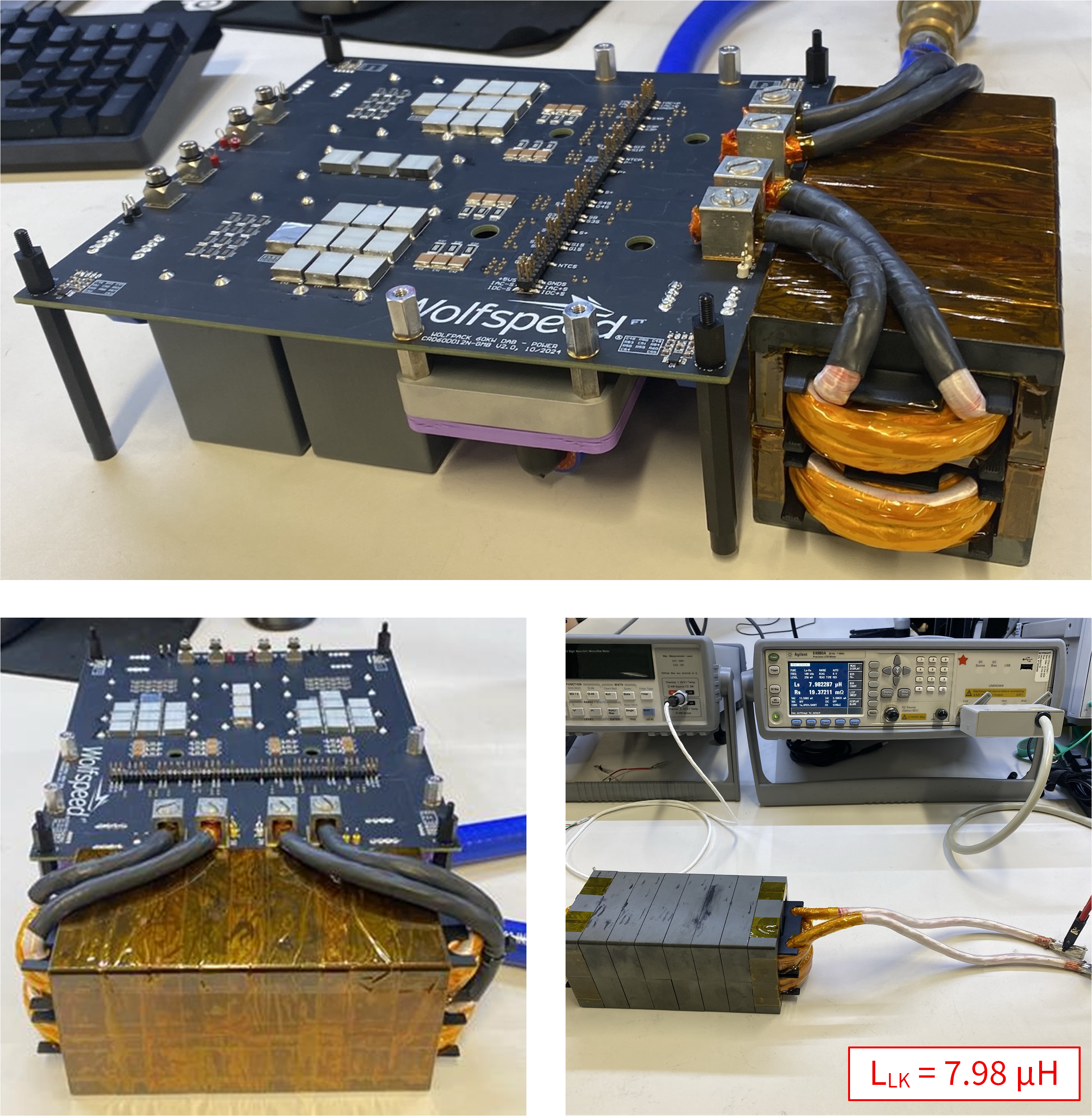

I am intersted to understand few things on the Transformer. You have already mentioned that it is a custom made one and you are working with magnetic partner to have detailed public release.
Will you please give me the detailed information regarding the transformer used for this module. We are trying to build this from our end taking yours as reference. This will be really helpful for the quick progress to our work and can be a good starting point on the magnetics.

    The transformer used for internal commissioning testing used Np=Ns=4, 8 pairs Ferrocube E80/38/20-3C94 cores, and Litz wire. I provided some pictures of the setup below.
