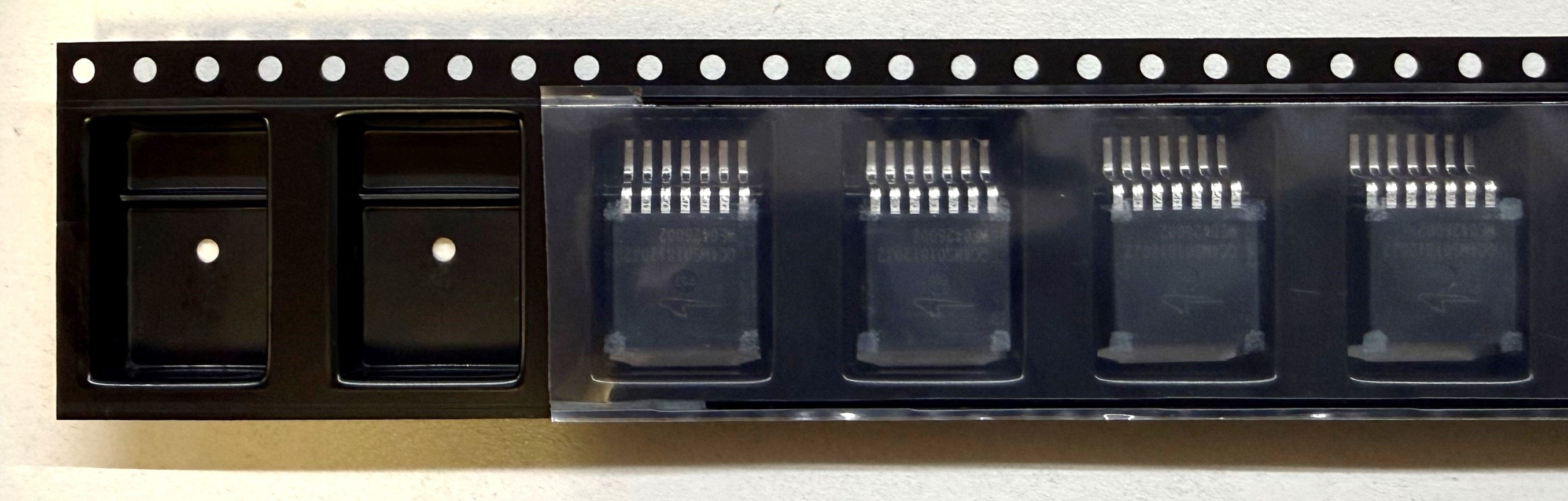

I would like your help to confirm what is the device orientation within the reel.
C6D10065G-TR
  • AustinC
    AustinC Wolfspeed Admin - Contributor Level 4
    Hi GustavoR,

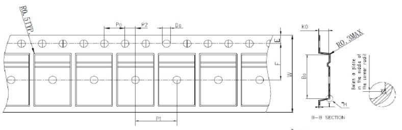

    The Power Product Packing & Shipping Reference Guide is intended to include the orientation of the G package in the tape & reel. Based on the image for the G package from that document, I see that it's not explicitly obvious which direction the package is inside the reel. The leads are located in the thin section and the body of the part is located in the wider section. I've included an example image of the TO-263-7L below, which matches the reel orientation for the G package.
