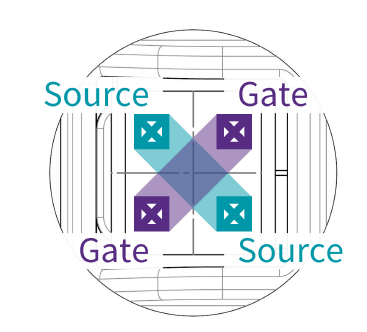

Can I give gate source signal from the gate driver to one of the gate source pair and leave the other pair open for the inverter design? If not then please let me know what can be the possible issues?

Hi Aradhya,
The two gate pins and the two source pins are connected internally in the XM3 module. You have the option to only supply the VGS signal to 1 pair of pins and the module will function. For the best performance and reliability, we recommend that both pairs of pins are utilized.

Will the open pin be affected by some unwanted signal
