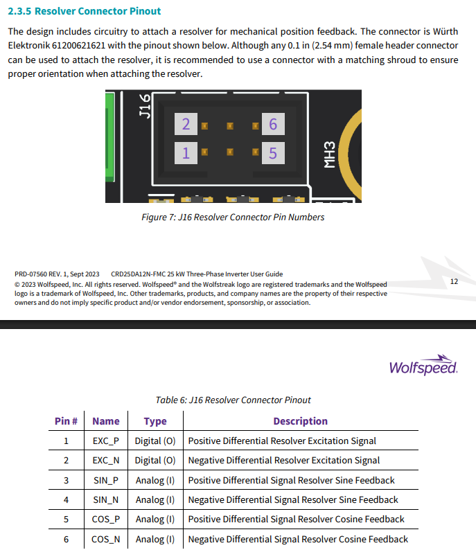

    Although we have not tested that exact resolver, it will likely work with this inverter. The provided Wolfspeed firmware does not include resolver feedback by default. However, the resolver firmware of TIDM-02014" rel="nofollow noopener ugc">TIDM-02014 by our partner, Texas Instruments, could be adopted to work with this design. Details to connect the resolver to this inverter are provided in Section 2.3.5 of the user guide (repeated below).
