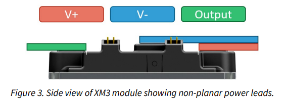

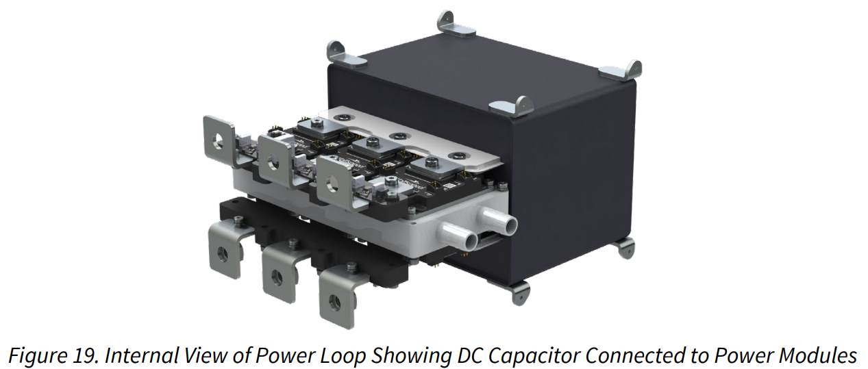

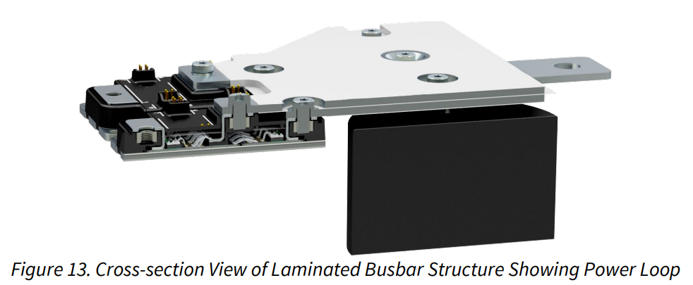

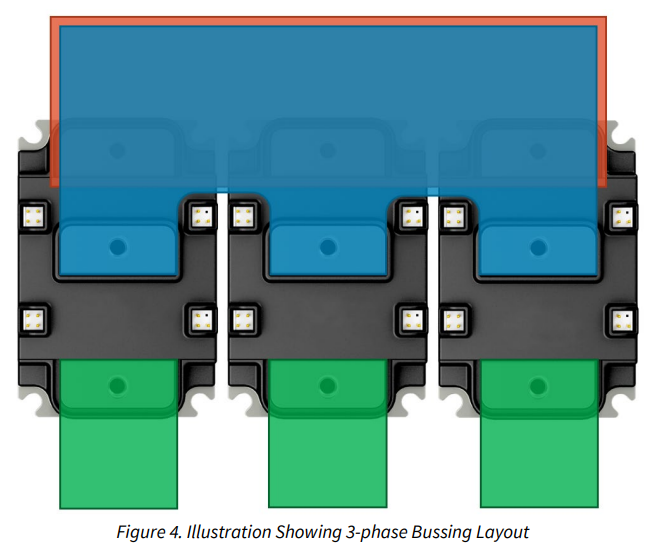

    ChrisN Wolfspeed Admin - Contributor Level 5
    Hello Pederas,
    The CRD200DA12E-XM3 reference design uses the CAB400M12XM3_data_sheet.pdf" rel="nofollow noopener ugc">CAB400M12XM3 power module with bus bars and the CGD12HBXMP gate driver. It is a great example of how to implement bus bars in your design. The user guide (PRD-06975) for that design provides figures demonstrating the recommended approach for bussing the XM3 power modules. Additionally, the CRD600DA12E-XM3 reference design also uses XM3 power modules (in an alternative configuration); its user guide (PRD-06976) provides some alternative bussing strategies. I provided some sample pictures below from the guides, though I encourage you to review the entire user guides.
    When designing your bus bars, we recommend that you adopt the following best practices:
    1. Ensure the DC+ and DC- layers are directly on top of one another to minimize inductance
    2. Place the bulk capacitors as close as possible to the modules to minimize inductance
    3. Do not overlap the AC outputs with the DC+/- layers to minimize coupling
