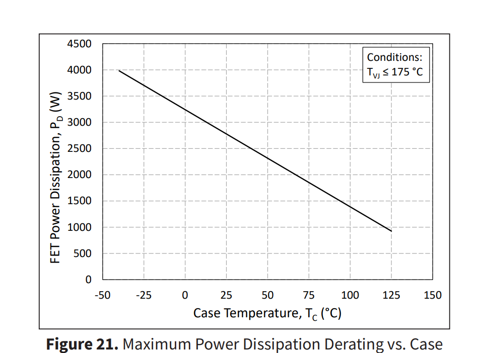

    3) Overall this question will depend on your system (TIM, switching frequency, bus voltage, Rg). Figures 20 - 22 in the datasheet can be helpful here. In general you should be able to use the plots in the datasheet (conduction losses, Rth, etc.) to answer this question. If you have any specific questions or additional details I can help you with this.

    3.1. DC continuous drain current is the max DC current that the module can support without violating the case temperature. You should always use maximum ratings to define SOA. However, depending on your system design strategy, it may not be a bad idea to design in some extra margins.
