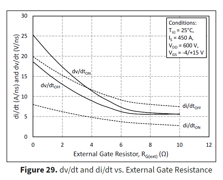

Hello,
I understand that the dv/dt(off) rating plays an important role in designing the Miller circuit to prevent false turn-on during the turn-off event. Could you please explain the significance of the MOSFET dv/dt(on) rating during the turn-on event?
Also what is the significance of di/dt(on) and di/dt(off) rating significance?
Thank you,
Gaurav
