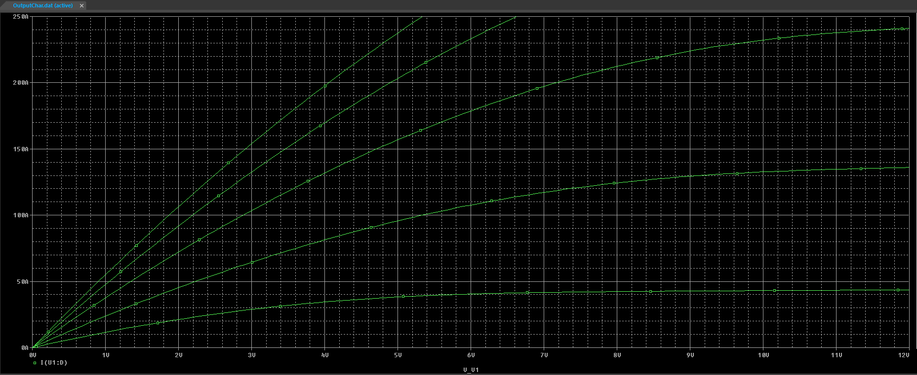

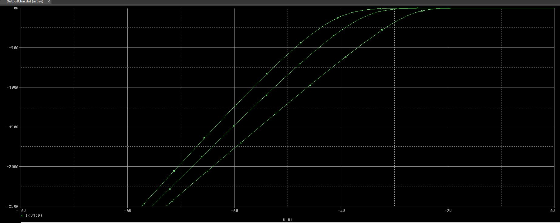

    I’m glad to hear that your changes to the model were successful! I wanted to let you know that I’ve also created a new PSpice-compatible model for you, which I've shared here. I’ve tested it under various conditions (Output characteristics and body-diode characteristics at 25C), and I’ve attached pictures below for your reference.
    Please feel free to reach out if you have any questions.

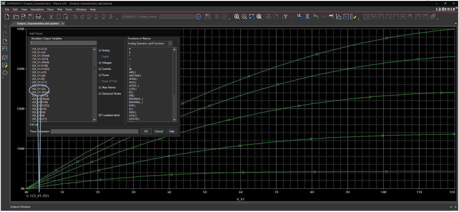

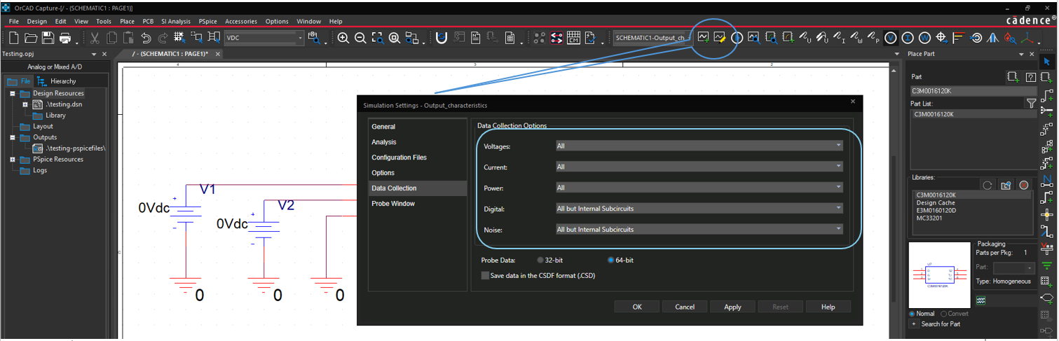

    Thank you very much for your help. Also, I would like to know how to operate if I want to observe currents in its subcircuits, such as Cgd, Cds, and currents on channels?
  • Mhusain
    Mhusain Wolfspeed Employee - Contributor Level 2
    Hello,
    To observe the currents and voltages of the subcircuit, you will need to select "All" for Voltage and Currents drop down boxes in the Data Collection tab of simulation settings as shown in the picture below.
    These internal Voltages and currents can then be selected from the "Add trace" selection box as shown in the picture above.
