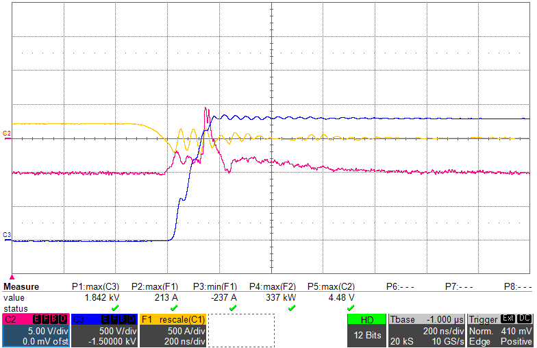

I am working on a double pulse measurements for SiC module CAB600M33LM3 module. I used Rg,off=1.5ohm and Rg,on=2.5ohm and my setup stray inductance is around 12nH. During reverse recovery of the high side diode (Applying double pulse at low side gate), I observe a voltage spike at the high side gate of around 5V peak. This is not observed when I check the reverse recovery of the low side diode. Please see waveform and help to analyze if this is normal or what to do to eliminate such voltage spike. I dont want to risk going into higher drain current because of the possibility of short circuiting the module when this spike really caused the high side switch to turn-on.
Channel 2: High side Vgs
Channel 3: High side Vds
Channel F1: High side Drain Current

    Hello Ralph
    Please share your company email ID and we can reach out to discuss your observations in more detail and provide the solution.
