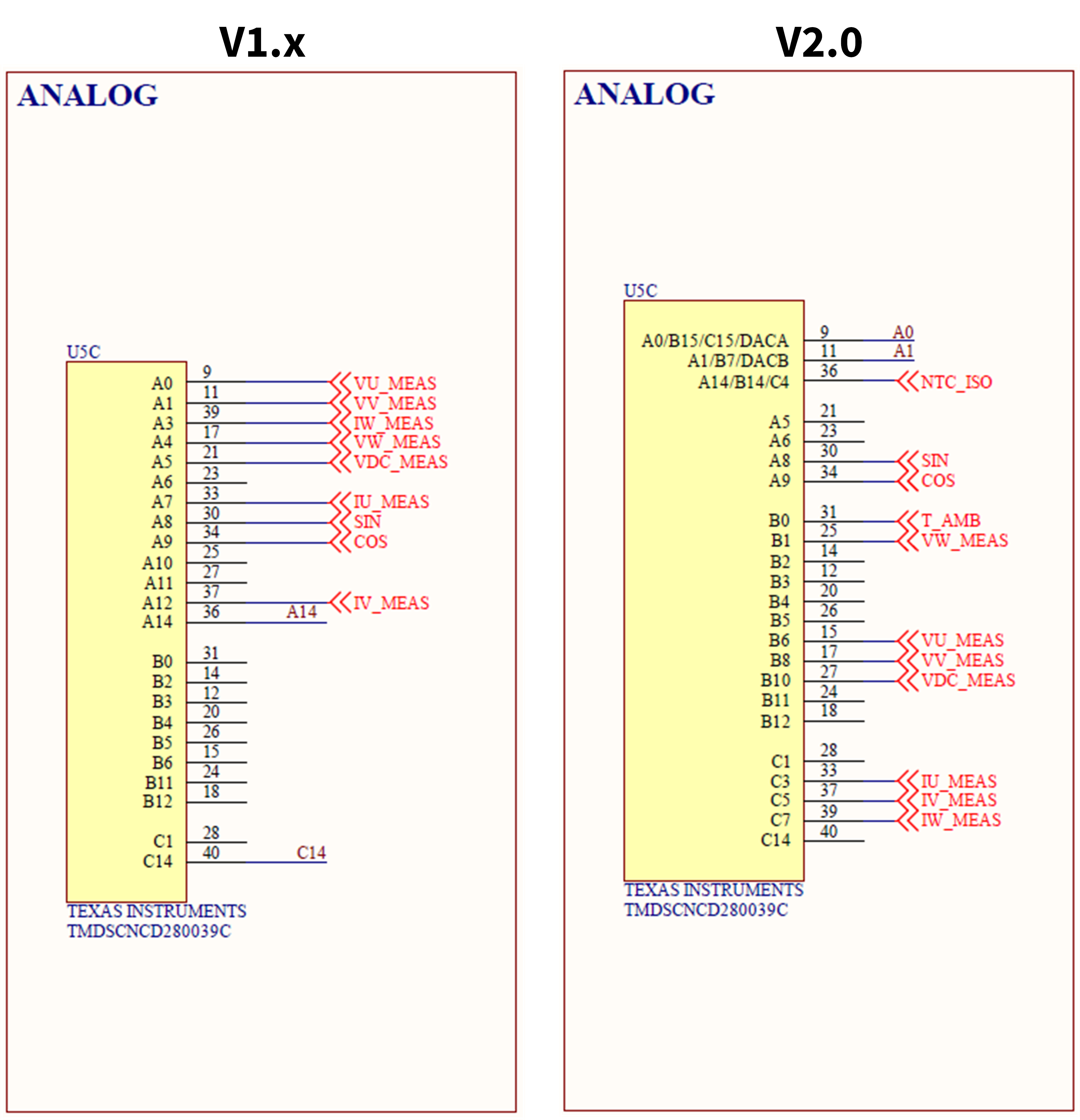

    Your issue sounds like it is related to upgrades we made to the V2.0 hardware. Several improvements were introduced in the V2.0 hardware based on additional internal testing and customer feedback. Most of these changes are backwards compatible with the firmware. However, the VDC pin mapping is not backwards compatible. The pin mapping of the VDC was swapped so that the voltages are all grouped on the same analog-to-digital converter (ADC) channel and so that the voltage & current measurements were on different ADC channels. This enables more flexibility with using the ADC post-processing blocks (PPB) that are built into the controlCARD and Code Composer Studio. The gate driver modulation was not affected by the updated hardware which would explain why the sinusoidal outputs are still working properly.
    I attached the updated firmware which fixes the pin mapping (this is the firmware that ships on the units). The new firmware (V2.0.0) transitions to using the SysConfig tool in CCS which is the current "best practice" for C2000 programming recommended by Texas Instruments. I also attached the updated schematic and provided a picture of the ADC differences below. We have an active request in for the website to get updated, so I expect the firmware and design files download links to be updated soon.

    My recommendation is to transition to the v2.0.0 firmware, as I mentioned in my previous post. However, if you have already put time into the v1.0.0 firmware (such as making customization or feeling more comfortable with the legacy coding approach), I attached a document which details the expected updates required to measure the new VDC pin. Please note I have not been able to test these edits on the hardware yet, so some minor tweaking might be required.
