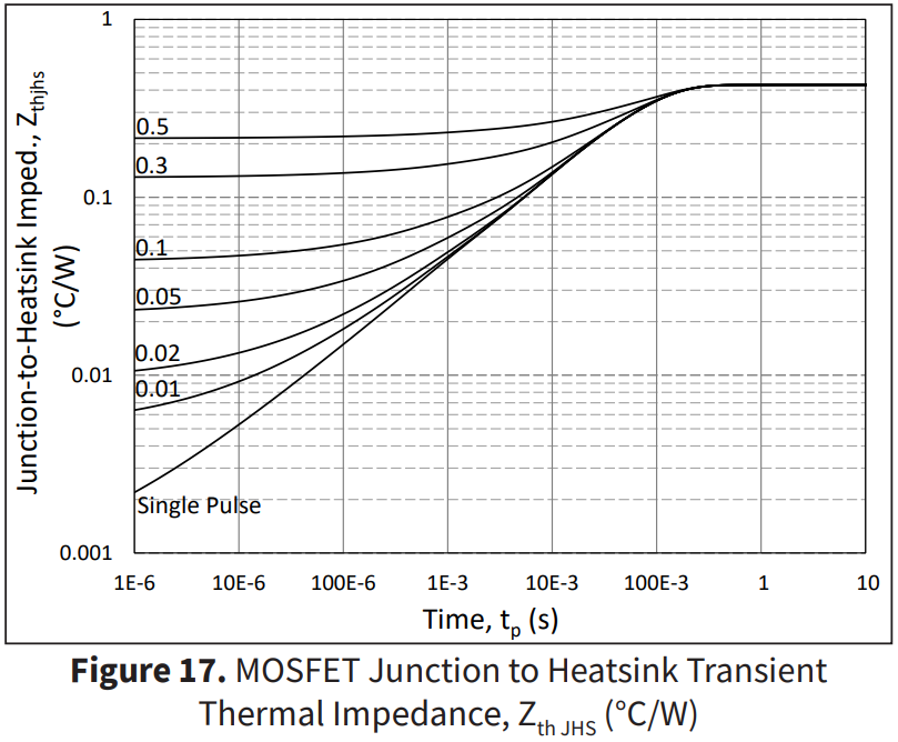

The application note "Thermal Characterization Methods and Applications" (PRD-08376) provides a lot of useful information for your design efforts. I recommend reviewing that application note for more details. Additionally, the datasheet for the CBB011M12GM4 includes a junction-to-heatsink thermal resistance value and thermal impedance plot (shown below). These can be used for estimating thermal performance and are already included in the PLECS and LTspice simulation files. The measured thermal resistance/impedance includes the influence of Wolfspeed pre-applied thermal interface material (TIM) which comes on the CBB011M12GM4T variant by default.

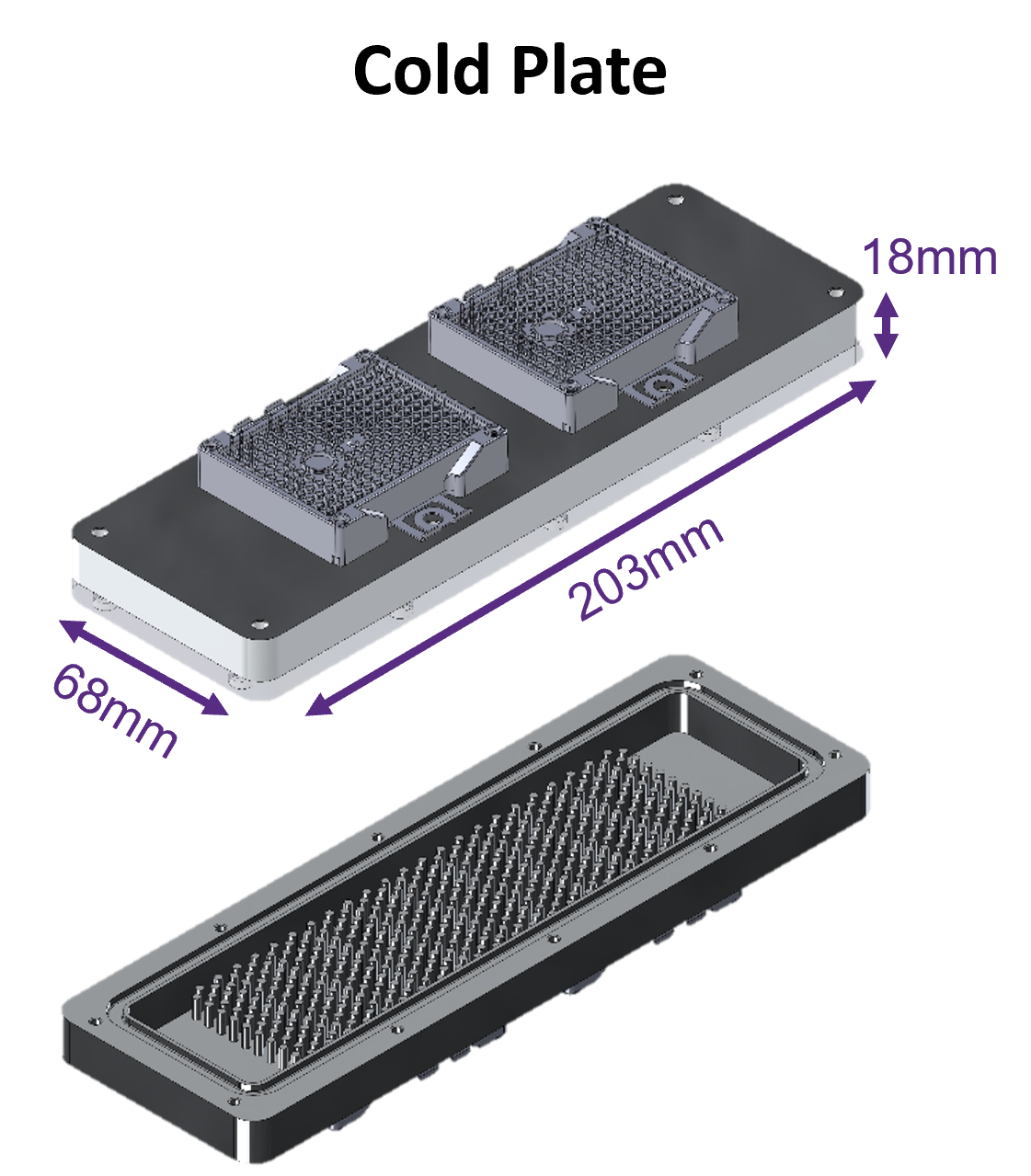

The CRD60DD12N-GMB uses a custom cold plate solution with integrated fins for improved thermal performance. It has a measured heatsink-to-fluid thermal resistance of 0.045 °C/W. I attached the STEP files for the cold plate design and a picture of the fins below for reference. This cold plate can be used as a starting point for your design, though it can likely be simplified due to your lower power requirement (20 kW instead of 60 kW).
