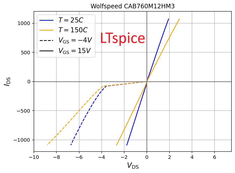

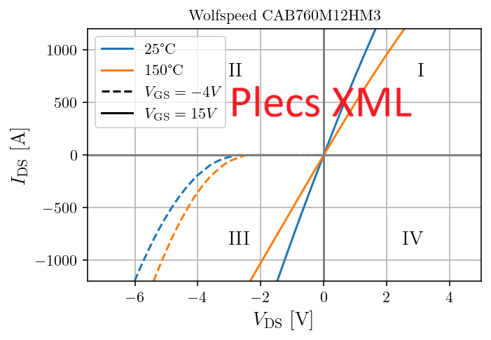

Hi,
I noticed that the Vds-Ids characteristics in LTspice of the CAB760M12HM3 module differs quite a bit from the datasheet values. The first plot shows the module characteristics using the LTspice model. The break in the body diode curve is not in the model, I just did not collect datapoints below 200A. The second plot uses data from the plecs XML file (which is way closer to the datasheet). Especially the fact that the diode temperature curves are swapped (150°C is above the 25°C) is not possible in reality.
Not only the body diode behaves very strange in LTspice, also the Rdson seems a little different. Did anyone else observe this behavior?
Thanks

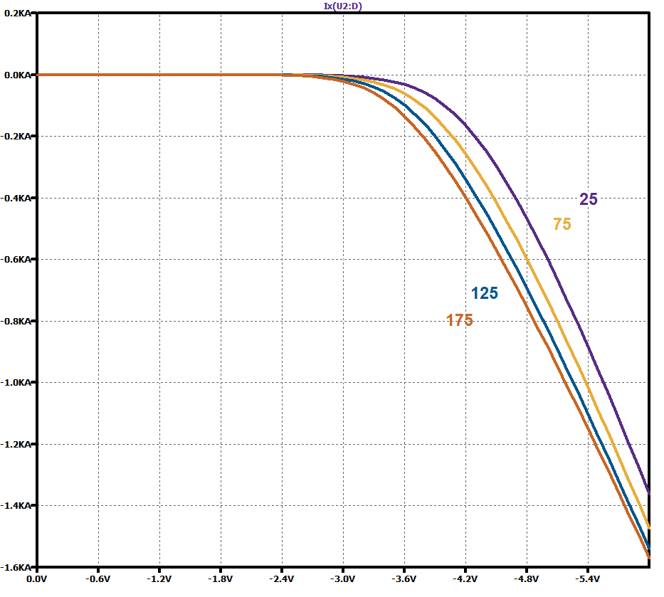

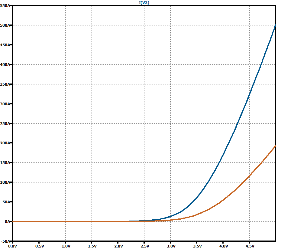

    I agree, something is definitely strange about that plot! At first I was a bit confused because I had not seen that behavior in the models and I was getting a different result in my testing than you are showing, e.g.
    Which came from this simulation:

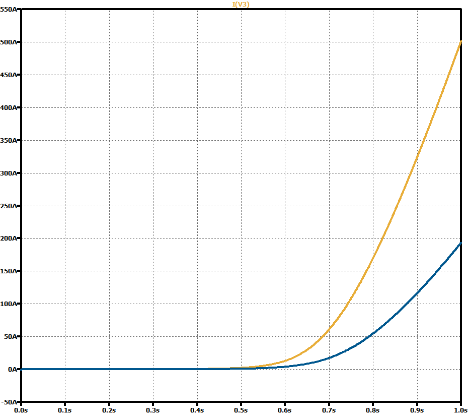

    I also saw similar behavior in a transient simulation:

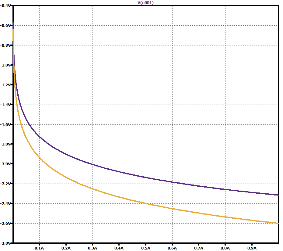

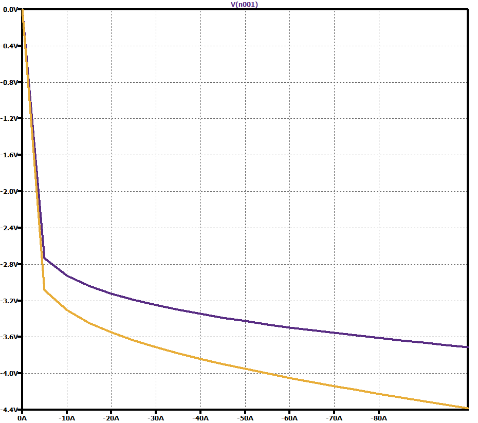

    I was playing around with things and then stumbled into this simulation:
    Which at first seems to replicate your simulations behavior:
    But upon further inspection I realized, I was seeing a large jump due to my poor choice of x-axis. Upon switching my dc sweep to ".dc oct I1 0.01 1 100", I got the much more reasonable,
    So I my best guess at this moment is that we're seeing a simulator issue / setup issue, but I'd be happy to help you with your SPICE simulation directly if you're able to share the file. You are also welcome to start a private message if you would rather not post it publicly.

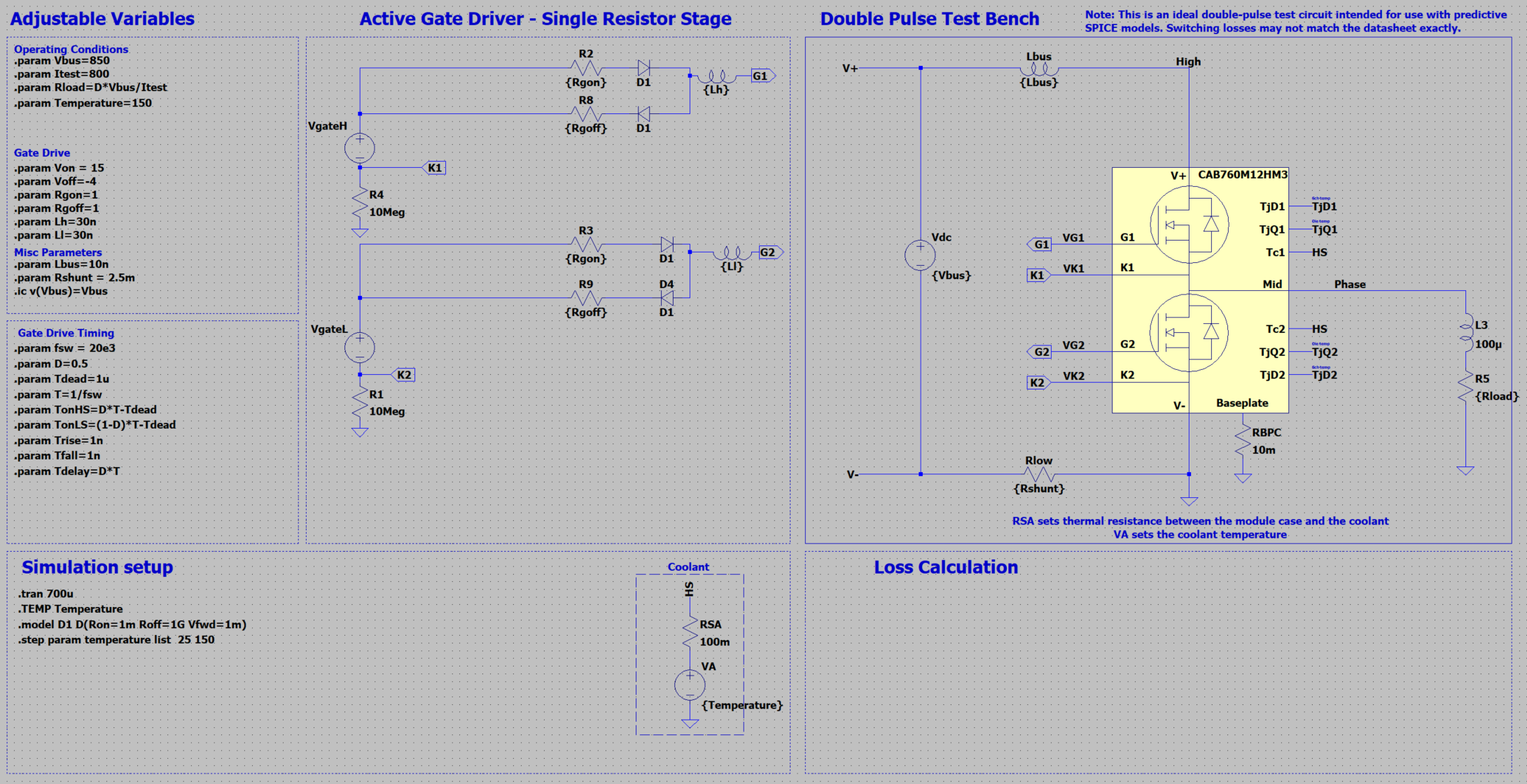

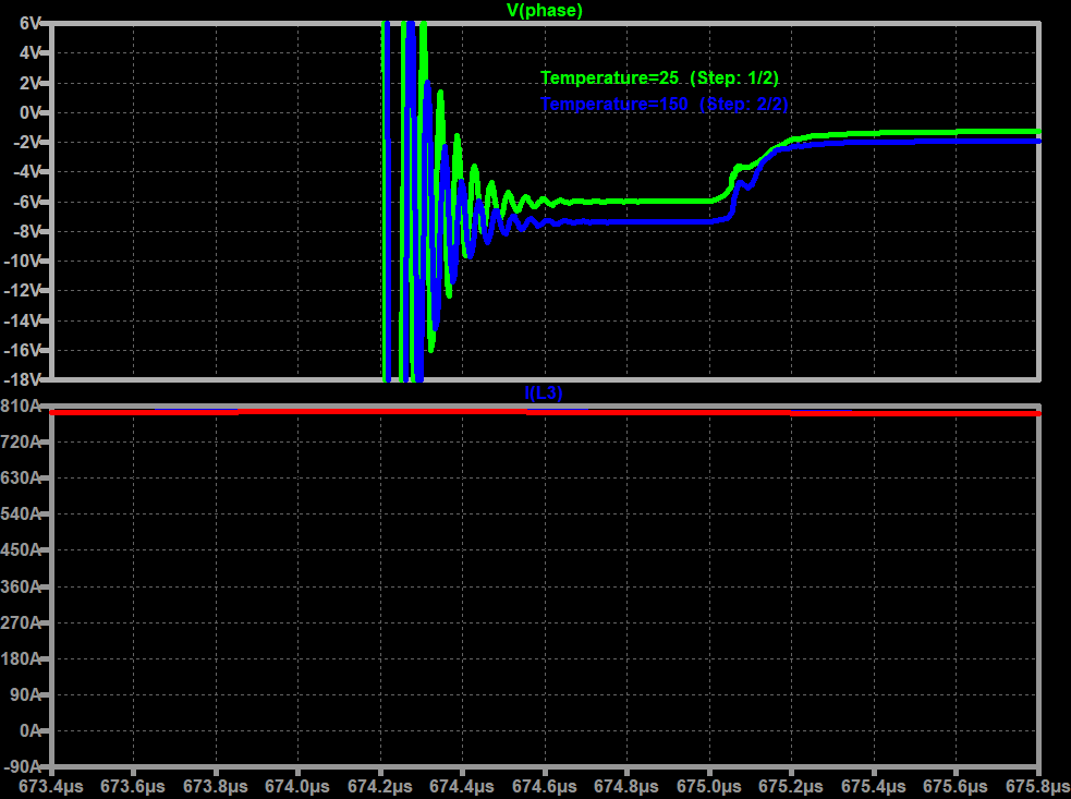

    thank you for your answer. Unfortunately, I can not see which trace in your plots is which parameter-set without legend. Also, I'm sorry I did not mention that I used the CAB760M12HM3 module-model.
    My setup uses the double pulse test bench you provide as an example and I adapted it for PWM operation. It looks like this:
    The diagram was created using a Matlab script, that automatically adjusts the parameters Itest and Temperature . I only added the .step param command for explanation now. Please find the model attached.
    The body diode voltage was then obtained by measuring Vds at time t_off_BD = 674.97e-6 s. Then it looks like this for example:
    So still the diode shows a positive temperature coefficient (should be negative) and the Rdson also shows a positive coefficient.
