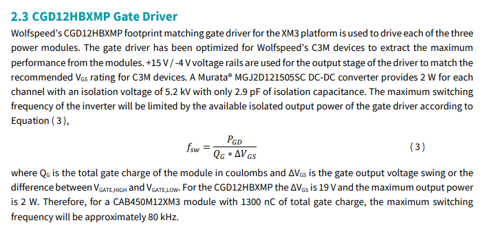

    The 80 kHz limit is based on the power rating of the isolated DC/DC converter on the gate driver. The calculation is provided in Section 2.3 of the CRD250DA12E-XM3 user guide (shown below). The gate driver is the only strict limitation to pushing the switching frequency higher on this inverter. We generally operate gate drivers lower than their theoretical limit to ensure adequate margin. Pushing the switching frequency above 80 kHz risks sagging gate voltages which could influence inverter performance. I'd recommend staying below this value. Most testing with this inverter is performed at ~20 kHz.
