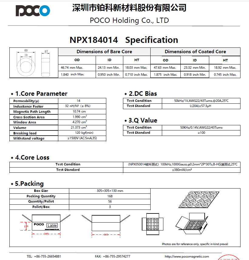

Hi, we are doing the design based on CRD-60DD12N-K. We are able to do loss modelling of switches and transformer but not for resonant inductor. Can you share more details on the core loss of inductor?
  • part no. of the core would be ok or
  • share the datasheet of the core or
  • share the core loss equation with respect to B and f
  • Hzz
    Hzz Wolfspeed Employee - Contributor Level 1
    Here is the basic info. of the core, it was just an engineering sample from POCO at that time, unfortunately, the supplier didn't share with us the details of core loss. You can reach out to POCO's contact (Vivien: vivien_luo@pocomagnetic .com) for details. thanks.
