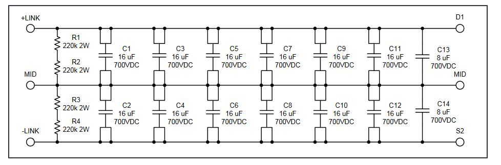

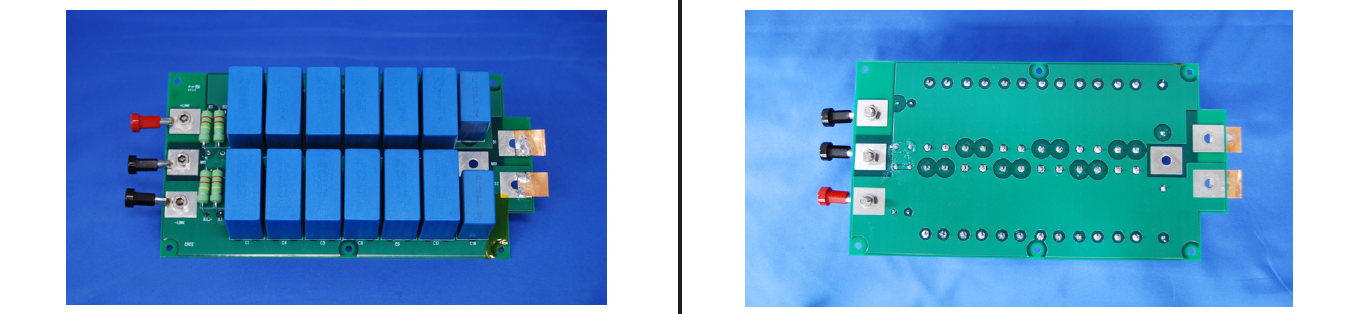

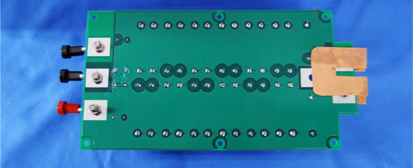

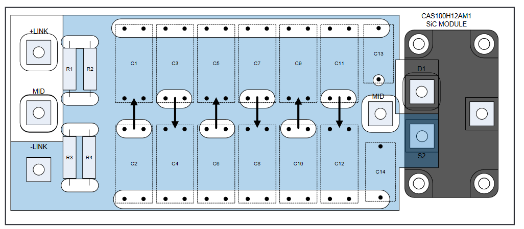

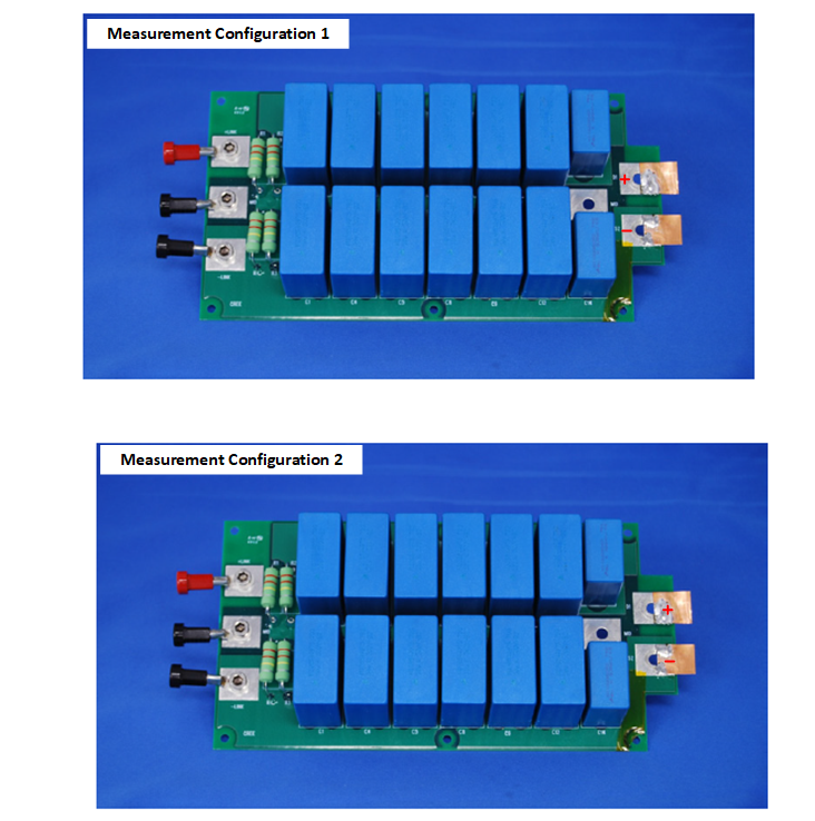

Hi Wolfspeed team,
These pictures are from the Design Considerations for Designing with Cree SiC Modules Part 2. Our customer wants to know how to measure the parasitic inductance of this Capacitor board. Whether it is necessary to short-circuit the module connection point holes at the right side?
