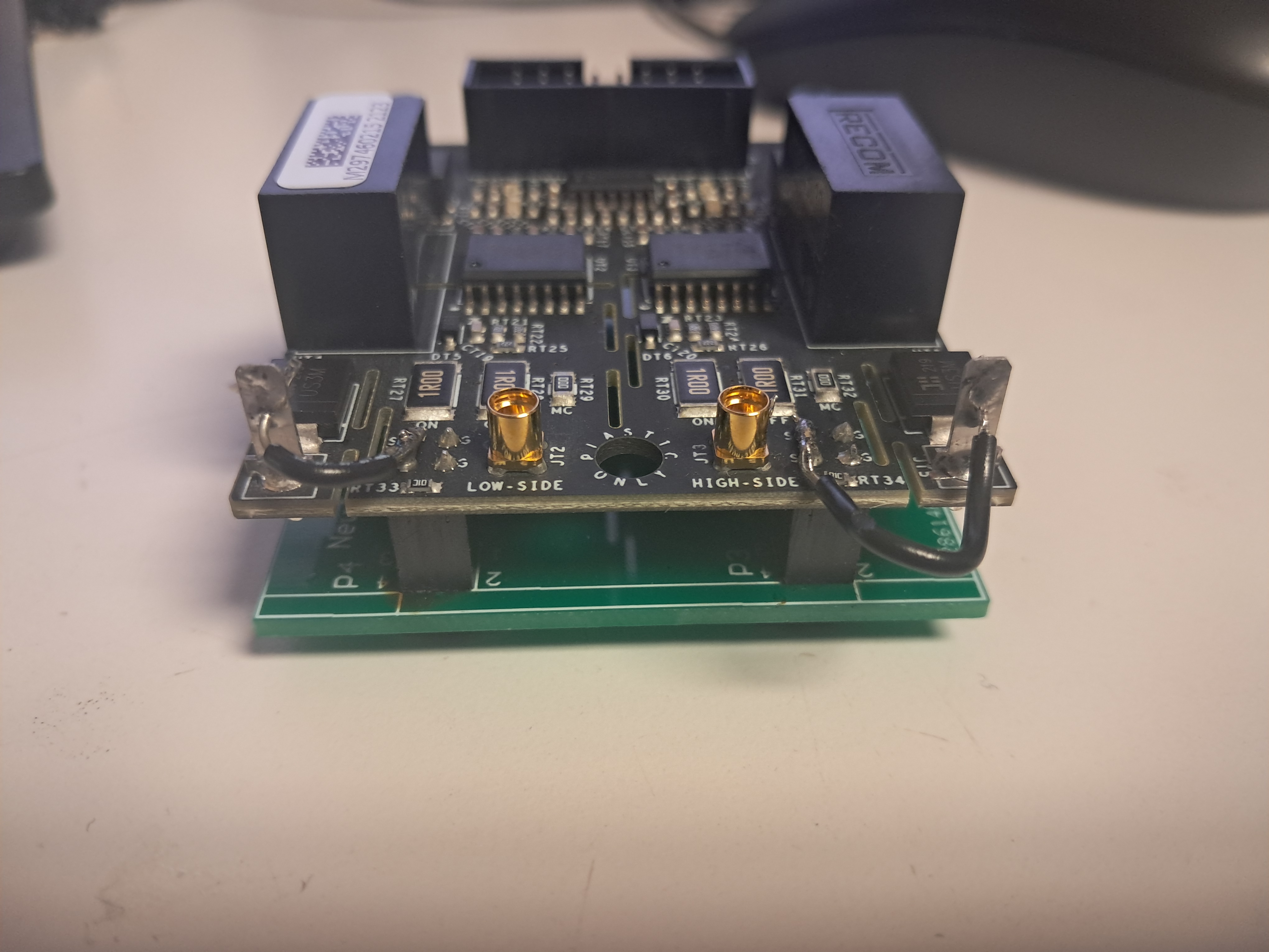

    Rather than shorting JT4 to JT5 to disable overcurrent protection, please short JT4 to the low-side source and separately short JT5 to the high-side source. We typically achieve this by soldering a wire from the spade connectors to the exterior shell of the MMCX connectors (JT2 for low-side and JT3 for high-side). I'll post a picture of an example when I swing by the lab later today.

    Thank you for the feedback.There is a mistake in the post. I did the same thing as you said. I shorted JT4 to low side source and JT5 to high side source. I am posting a picture of what I did.

    Thank you for the image; that looks perfect. What is the behavior of the driver now? I'm hoping the gate driver wasn't damaged during the initial 300 V operation with JT4 and JT5 shorted.

    Ok, understood, thanks for the additional info. It looks like your implementation of the overcurrent protection defeat is correct. Can you describe the inputs to your board? And when exactly does the driver produce the fault?
    Here is the example of one of our gate drivers from the lab:
