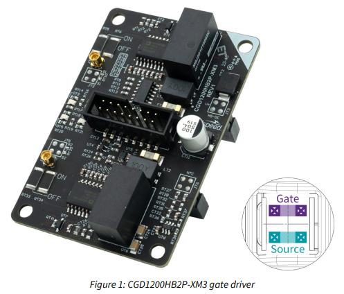

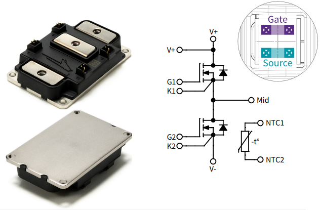

    I have one clarification. I found a document describing the inline and cross pinout configurations for the XM module, along with the corresponding recommended gate drivers. Based on my understanding, the CAB450M12XM3 has an inline pin layout and, therefore, may require the CGD1200HB2P-XM3 gate driver unit.
    Could you please confirm if my understanding is correct?

    You are correct that the CAB450M12XM3 has an inline gate pin configuration, and the CGD1200HB2P-XM3 is the recommended gate driver for it. For future reference, an easy way to validate the gate pin configuration is to refer to the gate pin diagram on the first page of every XM module datasheet. For instance, the below picture is from the CAB450M12XM3_data_sheet.pdf" rel="nofollow noopener ugc">CAB450M12XM3 datasheet and shows the inline pin configuration in the top right. The user guide for the CGD1200HB2P-XM3_Gate_Driver_User_Guide.pdf" target="_blank" rel="nofollow noopener ugc">CGD1200HB2P-XM3 gate driver similarly shows the inline gate pin diagram as shown below.
    CAB450M12XM3 Datasheet
    CGD1200HB2P-XM3 User Guide
