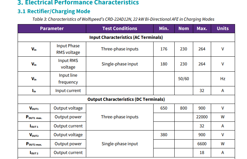

    Sorry, the CRD-22AD12N is not able to support the application as you mentioned, this demo is only able to operate in the specifications that were listed in the User Guide PRD-02282 as below:
    Thank you!
